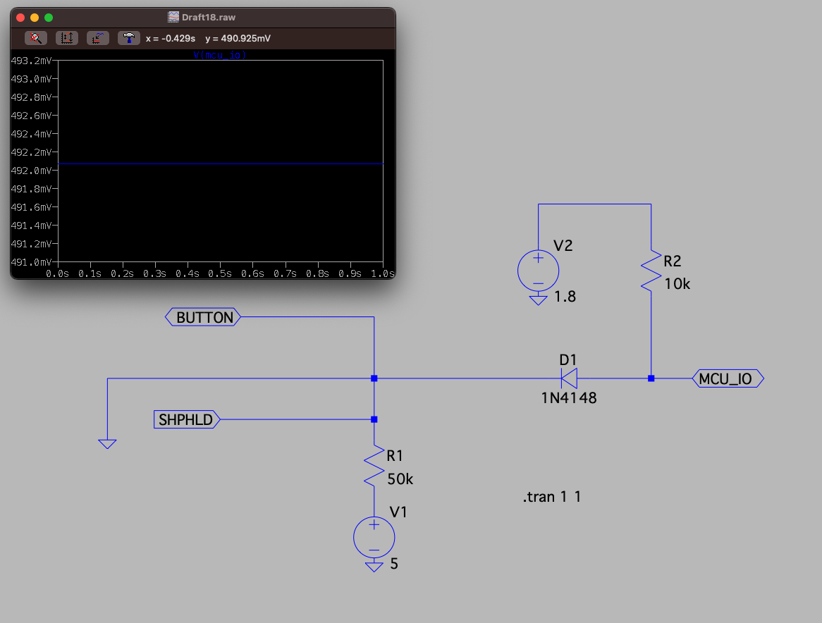

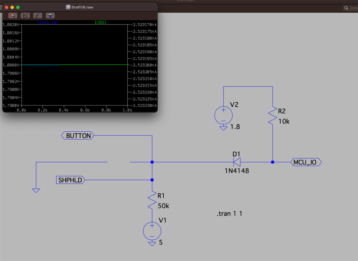

    I know this is an old thread, but I have the same design constraints, so I figured this answer might also be useful to others
    If you want to have the SHPHLD pin attached to a button that is also attached to the I/O of an MCU you could simply configure the button as active low and use a diode to prevent current from flowing from the SHPHLD pin towards the MCU.
    Here you can see how that would look like with the button pressed. The MCU voltage is still pulled to a logic low level.
    And here you can see what that would look like with the button unpressed/floating. As you can see there is no current flow
