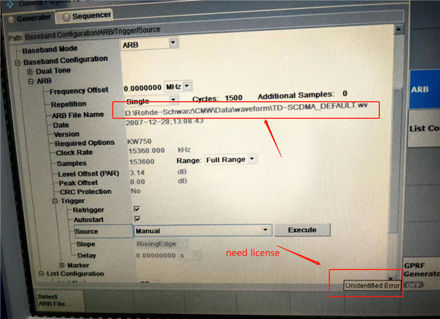

In the process of using nrf52840 to do zigbee functions, RF testing is required.
1、The software used is radio_test.
2、The test instrument is CWM500
No problems testing TX. But to test RX, I need to test zigbee's modulated signal. A waveform file is required on the CWM500. If the waveform files provided by the CWM500 are used, a license is required。
Please use can provide a zigbee carrier test waveform file.
