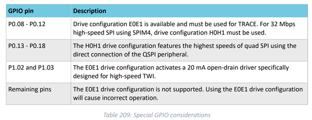

  • Hello Ahmed,
    Good to know that you have made progress and somehow the issue is resolved.
    I can see that you have set MISO pin (Pin 0.19) configuration as H0H1 drive.
    spis_config.miso_drive = NRF_GPIO_PIN_H0H1 ;
    From the product specification, we see that P0.13 - P0.18 should be used for H0H1 drive configuration from the Pin assignment chapter of nrf5340 product specification.
    BR, Naeem
