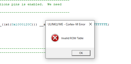

Got "Invalid ROM Table" when flashing the board through ULink2.
Hello everyone.
I am developing on a custom made board with nrf52832 but "Invalid ROM Table" occurs and I am not able to Flash to the device.
I have spent for a few days and tried many methods (such as changing settings, address, etc) that I found from Google.

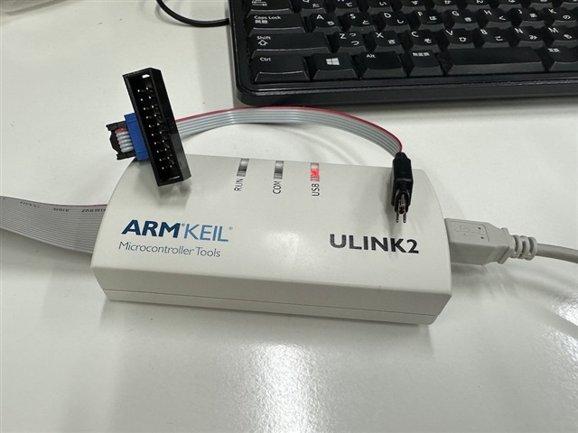

Flash device: ULINK2
Cables:
ARM-CTX(20-pin ARM to TC2030) Adapter for SWD
TC2030-IDC-NL Plug-of-Nails Cable

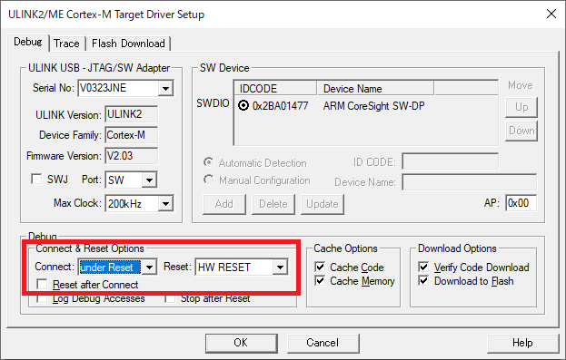

1. I have followed the troubles shooting guide (https://developer.arm.com/documentation/101455/0100/Troubleshooting-Guide) and I am able to detect the IDCode which is 0x2Ba01477 ARM CoreSight SW-DP.
2. When I tried a slow Max Clock to 20k Hz and I got another error message "Cannot Access Memory".
Is there any hints that could help me to figure out what speed should I use?
3. I have tried all the combination of Connect (Normal, with Pre-reset, under Reset, without Stop) and Reset (autodetect, HW RESET, SYSRESETREQ, VECTRESET) with no luck ("Invalid ROM Table").
4. In Flash Download, I have also tried Erase Full Chip and Erase Sectors with no luck ("Invalid ROM Table") and also played around with the RAM for Algorithm.

8. I have tried to create an empty project with main and a infinity loop, but the same "Invalid ROM Table" error occured.
The error message "Invalid ROM Table" has too less information. Any hints I could further try? Or if there is any log providing more information I could investigate?
