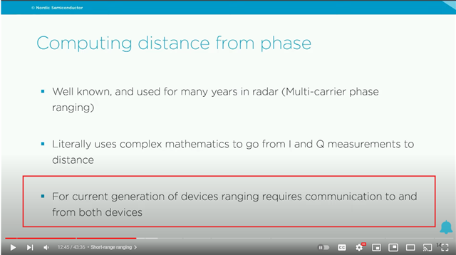

    I realised that I had misunderstood the webinar, specifically that the phase calculations themselves require 2-way communications.
    I had failed to comprehend this when I first watched it. I thought they were just referring to the synchronisation step, but instead it's actually happening during the DM timeslot also. In order to do the phase calculations.
    So I can't expect this to work at vast ranges, even if I can do one-way synchronisation.

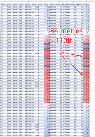

  • I did a test with the nrf_dm example with +8TX power and I can see that the range returned by ifft is good enough, and that the high-precision returns nan when the range is large. I think the estimates are about right
    I've not tested RTT mode yet. And I've not got CODED phy advertising to work (yet)
    It seemed to have poor reliability at this relatively short range however. I'm not sure if RTT will be more suited to longer ranges I'm not sure if the non-CODED scannable adverts are the problem, or it its because of the DM calculations.

  • The phase based ranging works reliably out to 8-10 meters, for longer ranges you should use RTT only. At longer ranges you are more likely to get incorrect resolutions for the range with the phase based ranging due to multi-path and similar.
    The RTT ranging requires that you can communicate over non-coded PHY so using coded PHY for the advertising will not increase your ranging capabilities.

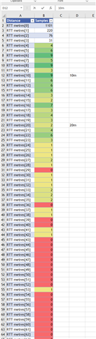

    I just tested RTT with the example again. Making a histogram of the number of samples for each metre.
    I walked away from the device and back again. Not very scientific. But it looks like the range was already struggling beyond 10m and was fairly bad by 20m. I will repeat the test.

    I repeated the test. This time being more careful to maintain line of sight. and got results upto 50m. Which is probably as far as I walked. It was too bright to use my laser pointer to verify the figures unfortunately.
    I will continue testing but I think it's unlikely I can promise my customers any more than 10m (30ft) reliably. Assuming they put it in their pocket etc. But it's still a useful feature, so I will try to include it.
