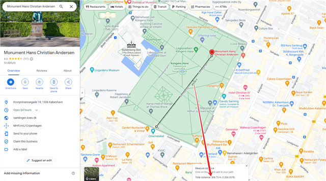

My product currently uses periodic adverts with CODED phy to send 12 periodic adverts per second which gives me an amazing range of over 300m. (see pic below)

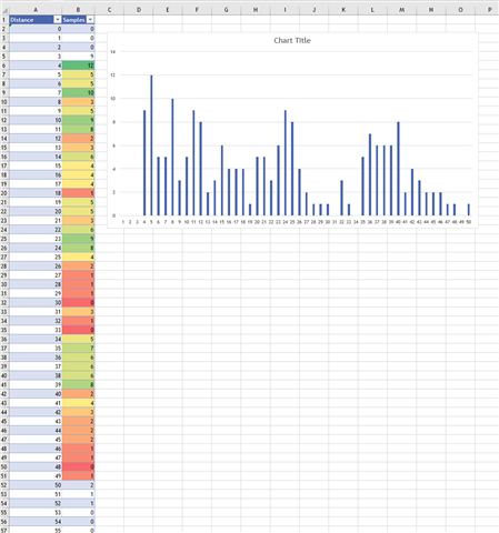

  • So for the Bluetooth range, we test several 100 meters with the standard DKs in line of sight,  Comparing range with Bluetooth Low Energy of the nRF21540 DK and the nRF52840 DK. The range will be highly depending on the environment so walls and similar will shorten it. Same for the PCB design and the antenna.
    Don't use phase based to estimate the range of the RTT as that will be overly pessimistic.
    You can use other synchronization mechanisms if you want, proprietary protocols will also work as long as you can get the synchronization good enough. We only offer the Bluetooth scanner/advertising sample but as the ranging is proprietary running in the timeslot API you can use any radio standard for the synchronization.
  • Thanks, I'd not seen those range tests before. Unfortunately I cannot use the nrf21540. I ordered the (hopefully) final PCBs this week. So I have to work with what I have.
    I repeated the test. This time being more careful to maintain line of sight. and got results upto 50m. Which is probably as far as I walked. It was too bright to use my laser pointer to verify the figures unfortunately.
    I will continue testing but I think it's unlikely I can promise my customers any more than 10m (30ft) reliably. Assuming they put it in their pocket etc. But it's still a useful feature, so I will try to include it.
    Thanks again for your help. It's much appreciated.
