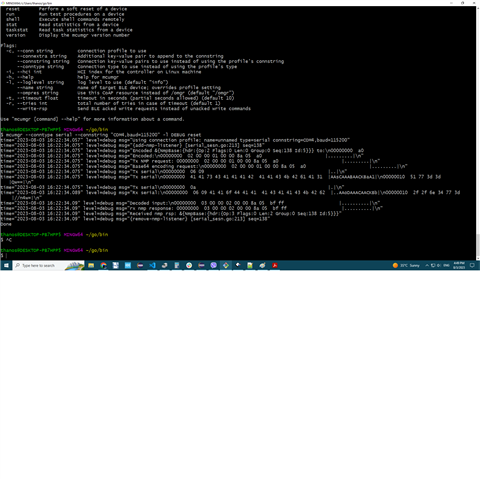

I have successfully update my NRF52840 device over serial using mcumgr cli.
I am trying to implement mcumgr protocol into another microcontroller (esp32) in order to update nrf52840 over WiFi.
My problem is that i am not able to reproduce the same result using base64 enconding/decoding.
I attach a debug overview between nrf52480 and mcumgr cli. I am aware of smp protocol (smp header + payload)
Reset Command:
Tx Request: 02 00 00 01 00 00 8a 05  a0
Tx Base64 Encoding:
Start Initial Frame: 06 09
Body: 41 41 73 43 41 41 41 42  41 41 43 4b 42 61 41 31  51 77 3d 3d
End Frame: 0a
I have used base64 online encoder/decoder and also implement my own to validate with no luck regarding the mcumgr output result.
One of base64 calculators: https://base64.guru/converter/decode/hex
Hex: 02 00 00 01 00 00 8a 05
MyBase64: AgAAAQAAigU=   MCUmgrBase64: AAsCAAABAACKBaA1
Could you please help me how this "body packet" is produced?
