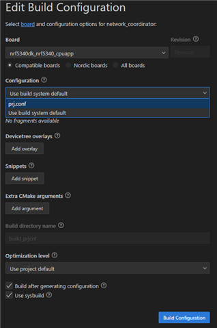

  • Hi, I was facing the same issue.
    The example comes with a "prj_fota.conf" and a "proj.conf". Selecting the "prj_fota.conf" instead of "proj.conf" when building did the trick for me.
    Maybe you can try this.
    I'm facing the same issue on a NRF5340 DK. I've selected NRF5340dk_NRF5340_cpuapp.
    I built the network_coordinator sample. Left everything default. I tried with Use build system default configuration and prj.conf as Configuration setting. I've tried with SDK version v2.5.0 and v2.3.0. I can't select any kconfig fragments.
    I also tried the light_bulb with the same results.

  • i fixed it by opening a different project (test project from months ago), with a different workspace. Selected:
    create new application,
    Copy sample
    [search for sample]
    save in the same workspace
    select add to existing workspace
    Board: nrf5340dk_nrf5340_cpuapp_ns
    Configuration: prj.comf
    Kconfig fragments: boards\nrf5340dk_nrf5340_cpuapp.conf
    overlay: boards\nrf5340dk_nrf5340_spuapp.overlay
    So it could be pathlength or workspace related or not actually copying the project to a new project (that caused me to be able to change the kconfig fragments and the overlay
