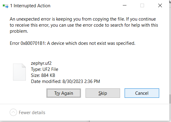

  • Using  the same flash0 configuration I get an error " region `FLASH' overflowed by 30676 bytes"
    Fixed that by increasing the image-0 region by that size
    It seems to be working - i.e the updated image is loaded and runs just fine but I always get an error copying the uf2 image
    When I click "Skip" it continues and I get "Upload complete" message and the updated image is loaded on the board
    I'm using adm_b_nrf52840_1_bootloader-0.7.0_s140_6.1.1.hex which I uploaded on the board with this command
     nrfjprog --program adm_b_nrf52840_1_bootloader-0.7.0_s140_6.1.1.hex --chiperase -f nrf52 --verify --reset
    Has anyone seen this ?
