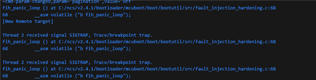

I cannot build the hello_world sample (and blinky for that matter). Target I have tested here is thingy53_NRF5340_cpuapp_ns. Everything is installed according to the recommendations using the nRF connect for desktop. The version of sdk is v.2.4.1
In VS code, I create a new application hello_world. Seems to work fine.
Add a build configuration for nrf5340 (thingy53). It generates 19 "problems" - out of the box - so to say.
I have thingy connected via Segger J-link Plus. J-link plus can access the thingy53/nrf5340 and download code. But this is no use when the code is broken.
Unfortunately there is no direct way to copy the "PROBLEMS" list to a file (would you believe !) from the darn VS Code (*1) so I have added a picture.
I have similar performance when building Blinky for same target. I have no interest in trying other targets as we will be using nrf5340.
Any ideas what I am missing? Looks like some path or configuration error but I am clueless as to what it can be. Should this not just work without further editing and with zero warnings?
