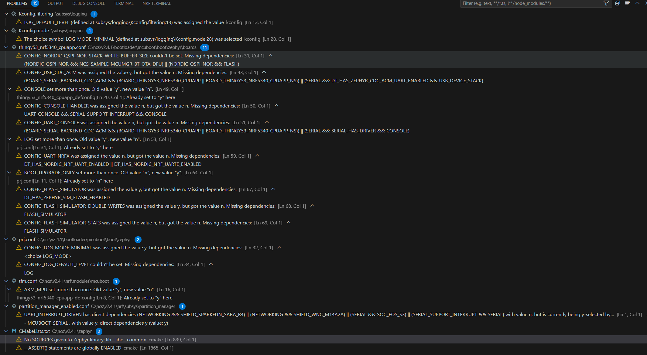

I cannot build the hello_world sample (and blinky for that matter). Target I have tested here is thingy53_NRF5340_cpuapp_ns. Everything is installed according to the recommendations using the nRF connect for desktop. The version of sdk is v.2.4.1

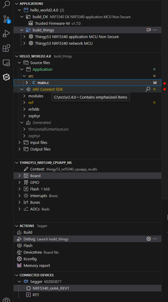

In VS code, I create a new application hello_world. Seems to work fine.
Add a build configuration for nrf5340 (thingy53). It generates 19 "problems" - out of the box - so to say.
I have thingy connected via Segger J-link Plus. J-link plus can access the thingy53/nrf5340 and download code. But this is no use when the code is broken.
Unfortunately there is no direct way to copy the "PROBLEMS" list to a file (would you believe !) from the darn VS Code (*1) so I have added a picture.
I have similar performance when building Blinky for same target. I have no interest in trying other targets as we will be using nrf5340.
Any ideas what I am missing? Looks like some path or configuration error but I am clueless as to what it can be. Should this not just work without further editing and with zero warnings?
(*1) It appears that I have to install an extension to copy the PROBLEMS at a textual listing - this is sort of - silly!

    Have you installed the SDK properly? Can you once try building from the command line using West? Please share the logs while building from the west. You can follow the steps mentioned here for building using West. Make sure your target board is thingy53_nrf5340_cpuapp_ns when building. I tested the hello_world sample inside NCSv2.4.0 for thingy53, and it's working fine on my side.

    Thanks for your answer.
    I installed sdk according to the recommendations using the tool for that. And I have tried two different pc's with same result.
    I have built as you suggest using bash terminal and it builds but with a number of warnings. Actually it also builds in VS code. But does not execute. (note 1#)
    I realize that the messages I describe above are warnings, despite they appear quite substantial like
    "No SOURCES given to Zephyr library: lib__libc__common"
    I also note that the "PROBLEMS" listing holds different warnings compared to the bash build - or do I have to open a logfile to see those when using west directly?

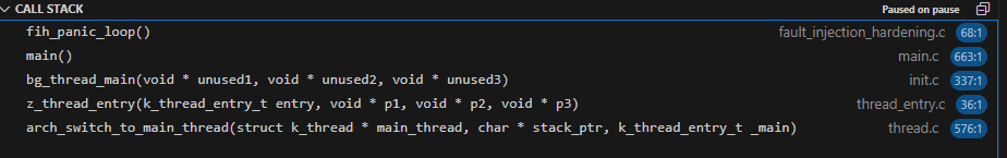

    Anyway, this warning issue may be an insignificant thing, but when I debug in VS code it never enters the main program but gets stuck inside the fih_panic_loop inside the file "fault_injection_hardening.c"
    I have built in VS code using debug enabled. So should that not just allow me to put a breakpoint in the main.c code and halt on that? It does not work.
    You say that you tested the code with v2.4.0 so I am curious do you also get a similar list of warnings and does the debugging work?
    thanks for your support. It is really a struggle to get this off the ground.
    Br henning
    Note 2#
    inside VS code, inside "fault_injection_hardening.c" (which opens when pausing the debug session) the line
    #include "bootutil/fault_injection_hardening.h"
    has: #include errors detected based on information provided by the configuration Provider setting. Squiggles are disabled for this translation unit. cannot open source file "bootutil/fault_injection_hardening.h"C/C++(1696)
    should that be a concern? Certainly looks like missing paths.
    (Note 1#) My reasoning: The debug did not produce running code, as described, so I assumed the warnings  which only manifest as errors at runtime and the reason for the broken debug code.

    Ok now I have from inside the nRF connect for desktop v4.1.2/ toolchain manager (TCM) v1.2.5 removed sdk 2.4.0, v2.4.1.
    Reinstalled from inside TCM sdk 2.4.0.
    Checked the voltage on the board (VOUTB=3.0V)
    Inside VS Code Build a hello_world app with target thingy53_nrf5340_cpuapp_ns with debug enabled.
    Added a breakpoint in the main.c code.
    Started debug: It downloads and verifies apparently correct.
    Then same as before never enters the main code but loops in fih_panic_loop()
    with this call stack and DEBUG CONSOLE listed below.
    I really hope you have an idea what can be wrong.
    In theory it can be a broken board and I can get hold of another. But I am not optimistic on that.
    Br henning

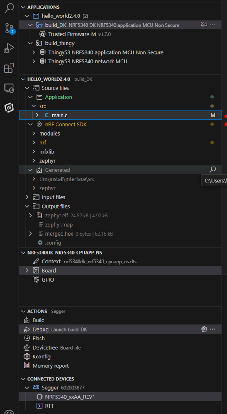

    I have still not been able to launch a succesful debug session with the Thingy53_NRF5340_cpuapp_ns as target for app hello_world. It builds but it fails to debug or run!
    You wrote that it builds for you but can you also debug the code - set a breakpoint in main and it stops execution there? This does not work here. Here it enters the panic loop.
    What _does work_ is build hello_world with target set to nrf5340dk_nrf5340_cpuapp_ns. But using the thingy53 board as actual target - = the same board as the failing case.
    This means that the hardware is working and at least some part of the procedure I take is right.
    Below are images of the VS code window when nrf5340dk_nrf5340_cpuapp_ns is the target followed by the similar window when switched to the other target Thingy53_NRF5340_cpuapp_ns. I.e. the hello_world application is set to have two targets but in this case same physical hardware.
    I notice one peculiar thing - the layout of the build_XX folder display (see below images) is different in the two different target builds - is this to expect?
    Why is is different and what causes this?
    Do you see the same difference? At least the debugging works different here.
    Any idea why the hello_world/Thingy53_NRF5340_cpuapp_ns  does not run here?
    henning
    Summary:
    a) hello_world with build target=Thingy53_NRF5340_cpuapp_ns  on Thingy53 HW --- Does build but not debug/run
    b) hello_world with build target=nrf5340dk_nrf5340_cpuapp_ns on Thingy53 HW --- Does build and run.
    VS code window when nrf5340dk_nrf5340_cpuapp_ns is the target:
    And here is the similar window when switched to the other target Thingy53_NRF5340_cpuapp_ns
  • I really would appreciate to know at least this:
    Does the hello_world demo application built for the Thingy53_NRF5340_cpuapp_ns as target run and debug out of the box?
    I can't get it to work.
