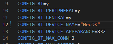

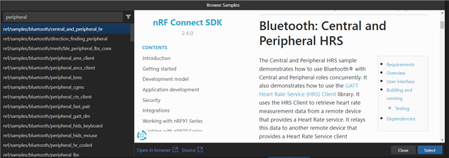

    I started with Bluetooth Central and Peripheral HRS Sample in NCS 2.4.0
    I just changed name of the device in the prj.conf
    I built it for NRF52840DK, and then flashed it to the DK using VS Code.
    On the phone, using nrf connect mobile app, I started the scan and could see the name of the DK, confirming that the sample on DK is working (Led also blinking).
    Next, I turned off the DK, and disconnected it from the computer (removed the USB cable).
    Then I inserted the Coin Cell, and turned ON the DK (SW9 in the VDD position)
    I was able to see that the DK led is blinking.
    I restarted the scanning on the phone, and could see the NeoDK name appearing confirming that the device is working and advertising.
    Just attaching snapshot of the DK working with Coin cell, and the snapshot from the mobile app.
