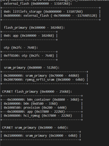

4. Problem Description/ Question
I want to utilize mx25u128 which is 128MiB with partition manager.
- Build Error: Attached detailed error messages at the bottom of the post. How do I fix this?
- Enabled BT, so had to use Partition Manager. I used CONFIG_PM_PARTITION_SIZE_LITTLEFS and CONFIG_PM_PARTITION_REGION_LITTLEFS_EXTERNAL to set littlefs_storage's size. How do I achieve the same thing using pm_static.yml?
- Here is partition manager report. Under external_flash, the size of external_flash is negative. How do I fix this?
- in overlay, how do I fill "sfdp-bfp" section for mx25u128?
