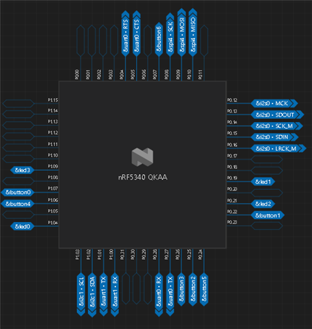

echo i2s sample won't build on custom board - 5340
Hi we're building the i2s sample on a custom 5340 board, but getting these build output errors:
Building echo

../src/main.c: In function 'main':
C:\ncs\v2.4.0\zephyr\include\zephyr\device.h:84:41: error: '__device_dts_ord_DT_N_NODELABEL_i2s_rx_ORD' undeclared (first use in this function)
84 | #define DEVICE_NAME_GET(dev_id) _CONCAT(__device_, dev_id)
C:\ncs\v2.4.0\zephyr\include\zephyr\toolchain\common.h:132:26: note: in definition of macro '_DO_CONCAT'
132 | #define _DO_CONCAT(x, y) x ## y
C:\ncs\v2.4.0\zephyr\include\zephyr\device.h:84:33: note: in expansion of macro '_CONCAT'
C:\ncs\v2.4.0\zephyr\include\zephyr\device.h:210:37: note: in expansion of macro 'DEVICE_NAME_GET'
210 | #define DEVICE_DT_NAME_GET(node_id) DEVICE_NAME_GET(Z_DEVICE_DT_DEV_ID(node_id))
C:\ncs\v2.4.0\zephyr\include\zephyr\device.h:227:34: note: in expansion of macro 'DEVICE_DT_NAME_GET'
227 | #define DEVICE_DT_GET(node_id) (&DEVICE_DT_NAME_GET(node_id))
c:\AtlantisRXApplication\echo\src\main.c:249:49: note: in expansion of macro 'DEVICE_DT_GET'
249 | const struct device *const i2s_dev_rx = DEVICE_DT_GET(I2S_RX_NODE);
C:\ncs\v2.4.0\zephyr\include\zephyr\device.h:84:41: note: each undeclared identifier is reported only once for each function it appears in
C:\ncs\v2.4.0\zephyr\include\zephyr\device.h:84:41: error: '__device_dts_ord_DT_N_NODELABEL_i2s_tx_ORD' undeclared (first use in this function)
c:\AtlantisRXApplication\echo\src\main.c:250:49: note: in expansion of macro 'DEVICE_DT_GET'
250 | const struct device *const i2s_dev_tx = DEVICE_DT_GET(I2S_TX_NODE);

Here is our devicetree:
And here is our PRJ.CONF:
CONFIG_I2S=y
CONFIG_PRINTK=y
CONFIG_MAIN_STACK_SIZE=2048
CONFIG_USE_SEGGER_RTT=y
I've attached the project as a zipped file. Is there anything that is pointing to the error? Is a kCONFIG not set? Or is there something else with the driver bindings I'm missing?
