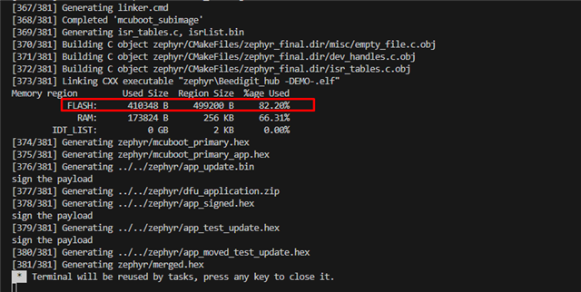

  • Thanks for the quick feedback!
    I did as you wrote. The project started building without errors.
    But I see that the flash is still used by the nRF52810 to write the firmware image:
    I need to place specify that the image will be placed on an external flash (AT45DB0).
    I can give my project to you, maybe it will help you?
  • I need "mcuboot_secondary" to be on external flash (AT45DB0).
