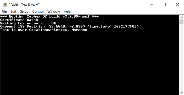

I'm trying to build this sample: https://docs.actinius.com/getting-started/samples/iss-position - build works fine. When I flash it to the icarus board using the actinus serial programmer it doesn't output anything on the nRF serial terminal program.
However, when I go to https://console.actinius.io/serial-programmer and use the prebuilt sample for iss-position it works, and I can view the output in the nRF serial terminal program.
I've tried the build config w/ 'nrf9160dk_nrf9160_ns' and 'actinius_icarus_ns', and neither work. In the past with this board I was able to build this iss-position sample and flash it, and get an output.
I'm not sure what to do to troubleshoot this - I can't see how the samples on the actinius console were built, and when I build them on my computer and flash them, i get no output in the terminal, so debugging is kind of impossible.
Here is the build log for the last pristine build I did for the iss-position sample, w/ the 'actinius_icarus_ns' board config :

If anyone could help me figure out this problem that would be awesome - or point me to any resources.
    Please have a look at this warning; Console is not getting enabled.

    First, some notes and assumptions:
    - I am assuming you have an Icarus IoT Board v2.
    - The modem firmware on my test device here is v1.3.5, however any modem firmware that is compatible with nRF Connect SDK version 2.2.0 is fine. In any case, since the pre-built sample as you say works, this is not an issue in your case.
    - The bootloader on the device is the one that the Icarus comes preinstalled with (unless you have used a JLink programmer, this is immutable, so yours is the preinstalled as well. Also, since the pre-built sample works, this is confirmed)
    My steps:
    1) After the nRF Connect SDK v2.2.0 installation, I installed the latest board files from https://docs.actinius.com/icarus/board-files
    2) Downloaded the sample and opened with VS Code
    3) I have multiple SDKs installed so I did
    F1-> Select nRF Connect SDK
    and
    F1->Select nRF Connect SDK Toolchain
    4) Clicked on "Add build configuration" in the nRF Connect tab in VS Code
    5) Selected actinius_icarus_ns and did a full build
    6) uploaded /iss-position/build/zephyr/app_update.bin using the Actinius Serial Programmer
    7) Connected with TeraTerm, pressed reset and the samples started doing its work:
    I hope this helps.
    In case you are still experiencing issues, I would suggest that you contact Actinius Support ([email protected]), thank you.
    -- Mike
