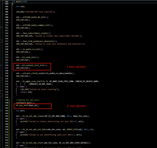

    i added the NUS service to the nrf5340_audio example act as Gateway. I also can connect to the device using NRFConnect application, but no services or characteristics appear on the NrfConnect app.
    if i comment 1.mcs service in line 726 and reflash the Gateway, the NUS service appear on NrfConnect app. any suggestion?
    nrf5340_audio_01.zip
    In the fuction bt_mcs_init() located in  \v2.6.0\zephyr\subsys\bluetooth\audio\mcs.c
    when i comment  bt_gatt_service_register(&mcs), the nrfconnect app could show the NUS services.
    Is it MCS service take too much room which cause the NUS service can not be registered?

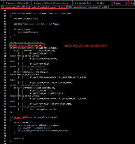

  • it seems bt_nus_init() only register callback and  return 0 directly. nus service was static register with marco BT_GATT_SERVICE_DEFINE.
    the mcs service was registed with bt_gatt_service_register() fuction in line 1348 of  .
    my question is whether static and dynamic registration of services can coexist?
    Have you also added the nus files and kconfigs to your project?
    Yes, you my have static and dynamic registration of services in your application.
    You will just need to make sure that your call to bt_gatt_service_register for the dynamic part does not violated the sequence order as described in the API reference documentation.
    If you do dynamically change your services you will also need to use the 'services changed' service to alert a peer that it needs to do a new discovery (since all services and characteristics are discovered and cached upon connection).
