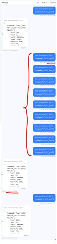

  • Messages sent from the nRF9160 Development Kit (DK) to our MQTT server are delivered promptly and reliably.
  • However, when attempting to send messages from the MQTT server to the DK, the process is sporadic, especially when the modem enters Idle mode (as indicated by +CSCON: 0 and RRC mode: Idle).
  • It's important to note that this behavior is not observed when using an iBases SIM card with an identical hardware and firmware configuration.
  • During my testing phase, I inadvertently altered the PSM settings for a specific Truphone eSIM, probably leading to the TAU value of 10800 and an Active time of -1.
  • The firmware and settings are uniform for both the Truphone and iBasis SIM card configurations.
  • PSM has been explicitly disabled using the lte_lc_psm_req(false) function in my firmware.
  • The PSM parameter update for the Truphone SIM card that consistently exhibits the issue is: TAU:10800, Active time: -1.
  • I have also checked another Truphone SIM card, which now shows the expected PSM parameter update of: TAU: 3240, Active time: -1.
  • I have also checked another iBasis SIM card, which now shows the expected PSM parameter update of: TAU: 3240, Active time: -1.
