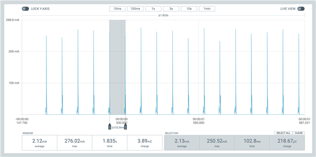

I'm playing around with the wifi/shell sample on the nRF7002dk, and I am trying to enable PSM through the command line interface however when examining the power consumption of the board using the Power Profiler Kit II, it doesn't seem like PSM is working. Below is a screenshot of the power consumption and the wifi shell configuration.
