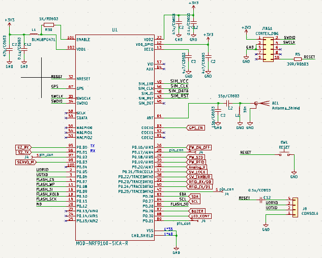

custom nrf9160 board JLink/SWD programer
Hi, we tri to develop a custom board base on nRF9160 SICA B0 and  can't flash the board via SEGGER JLink/SWD programmer. On nRF Connect for desktop programmer on selectdevice i don't see ani device.
my schematic:
the log from nrfjprog:

from L-Link commander:
SEGGER J-Link Commander V7.90a (Compiled Aug 9 2023 15:02:13)
DLL version V7.90a, compiled Aug 9 2023 15:00:35
Connecting to J-Link via USB...O.K.
Firmware: J-Link ARM V8 compiled Nov 28 2014 13:44:46
Hardware version: V8.00
J-Link uptime (since boot): N/A (Not supported by this model)
S/N: -1
License(s): RDI,FlashDL,FlashBP,JFlash,GDB
VTref=3.325V
Type "connect" to establish a target connection, '?' for help
J-Link>connect
Please specify device / core. <Default>: CORTEX-M4
Type '?' for selection dialog
Device>?
Please specify target interface:
J) JTAG (Default)
S) SWD
T) cJTAG
TIF>S
Specify target interface speed [kHz]. <Default>: 4000 kHz
Speed>
Device "NRF9160_XXAA" selected.
Connecting to target via SWD
ConfigTargetSettings() start
---Setting ROM table---
ConfigTargetSettings() end - Took 2.24ms
Found SW-DP with ID 0x6BA02477
DPv0 detected
CoreSight SoC-400 or earlier
Scanning AP map to find all available APs
AP[7]: Stopped AP scan as end of AP map has been reached
AP[0]: AHB-AP (IDR: 0x84770001)
AP[1]: AHB-AP (IDR: 0x24770011)
AP[2]: JTAG-AP (IDR: 0x12880000)
AP[3]: APB-AP (IDR: 0x54770002)
AP[4]: JTAG-AP (IDR: 0x12880000)
AP[5]: JTAG-AP (IDR: 0x12880000)
AP[6]: MEM-AP (IDR: 0x128800A1)
Iterating through AP map to find AHB-AP to use
AP[0]: Core found
AP[0]: AHB-AP ROM base: 0xE00FF000
CPUID register: 0x410FD212. Implementer code: 0x41 (ARM)
Feature set: Mainline
Cache: No cache
Found Cortex-M33 r0p2, Little endian.
****** Error: Specific core setup failed.
Cannot connect to target.
J-Link>
What can be wrong? any suggestion appreciated.
