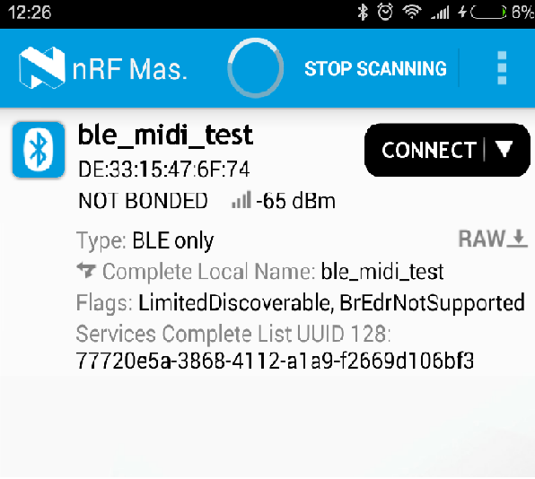

If only add service uuid, the nrf Master show the "Services Complete List UUID 128:" like this: image description
It's show the service UUID.
if add characteristic uuid ,the nrf Master show the "Services Complete List UUID 128:" like this: image description
It's show the characteristic UUID.
Is it correct?
