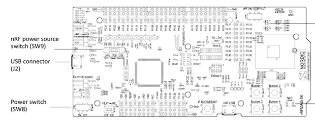

    I finally found some time to prepare a simple project running on nRF52840dk.
    I was able to reproduce the wake-up issue in the setup running on the DK. Same situation here - disabling BLE before going to sleep fixes the problem.
    Please find below the source code. There are only 3 files, but if you need a zip file, let me know then I can attach it as well.
    If there are any new findings or better (proper?) ways to overcome this wake-up issue, then please let me know.

    Two questions from me:
    - Do you power cycle the nRF52840DK after programming the board and before executing testing? This to ensure the chip is not in debug interface mode (which is not proper system OFF, but emulated system OFF). That is kind of the only thing I can think of that may cause this to fail.
    - Is there any difference if you add a __disable_irq(); before pm_state_force()? What if you use NRF_POWER->SYSTEMOFF=1; directly instead of pm_state_force().
    Kenneth
  • Hi Kenneth,
    After programming the nRF52840DK, and before running the test, I always switch the DK off, unplug and plug the USB cable back in.
    Regarding proposed modifications, here's the results:
    Mod 1:
