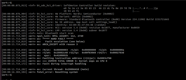

We're working with the nRF52840 DK and Dongle, and also the nRF53840 DK.
I have code based on the nRF Connect v2.4.0 SDK using OpenThread on 802.15.4 connecting to an OTBR implemented with an nRF52840 dongle running the RCP firmware.
I can publish messages successfully and reliably from a modified CLI firmware running on the nRF52840 dongle and also the DK and the nRF53840 DK.
However when I enable multiprotocol support I run in to trouble.
When I am scanning for bluetooth devices with a certain profile (GPS location) alongside the OpenThread support then the code locks up.
However when I run this code on the nRF52840 DK then it is fine.
I've had a look at changing stack sizes and so forth but nothing seems to help.
Can anybody help me understand what I am doing wrong here.
I assume from the documentation that Bluetooth + OpenThread is supposed to be supported with multiprotocol on nrf52840?

  • One of our OpenThread expert thinks that this could be memory related and also maybe due to the processing power difference (nRF53 has both more processing power and memory).
    As a first step you could try to increase the stack sizes and see if any of the memory optimizations tips mentioned here works. If that does not help, please share a minimalistic project for us to reproduce this.
