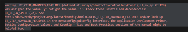

    At the beginning, I added the configuration flags to dynamically change the transmit power. I added these flags to prj.conf:
    # dynamically change the TX power level
    CONFIG_BT_LL_SW_SPLIT=y
    CONFIG_BT_CTLR_ADVANCED_FEATURES=y
    CONFIG_BT_CTLR_TX_PWR_DYNAMIC_CONTROL=y
    CONFIG_BT_CTLR_CONN_RSSI=y
    Adding these flags leads to the exception I posted above. That shouldn't really happen, right?
    After I removed the flags and added only the CONFIG_BT_CTLR_TX_PWR_PLUS_8. The application seemed to work.

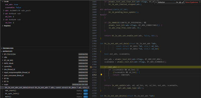

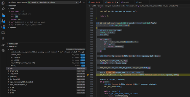

  • J0sh1101 said:
    I would still like to dynamically adjust the TX power. Is this possible?
    Yes you should be able to use HCI power control API and dynamically control the TX power. In your case it is hard to say what went wrong. Can you please enable the below in your config and run your application again?
    CONFIG_BT_LL_SW_SPLIT=y  #not sure why you want to use Zephyr controller?
    CONFIG_NO_OPTIMIZATIONS=y
    CONFIG_THREAD_NAME=y
    The aim is to get the thread name which is causing the fault. My best guess is that enabling all these features might be causing a stack overflow of some system queue or workqueue. Increasing the stack sizes of some of these common queues will help, but we need to know the thread name causing exception first.

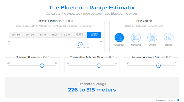

    NDT should NOT be used with coded PHY as all ranging is performed with non-coded PHY so trying to use coded PHY may make the devices visible further away but if you can't see them with 1Mbps then you can't range between them anyway so no benefit.
    This is something I don't quite understand. There are many sites (one site) and videos (one video) that claim you can increase your range with ble long range (PHY). If you can get your package to travel a longer distance, then that also means you can measure a longer distance using the RTT method. What am I missing here? The only problem is that the receiver cannot decode a single symbol due to very poor SNR.
    Advertising on coded PHY uses extended advertising and that to my knowledge does not support scan response, probably because it uses data channels in combination with advertising channels to do the job.
    What a bummer!! Afterwards I read also that this is not defined in the BLE specifications.

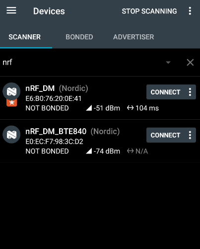

    After compiling, flashing and comparing both boards (nrf5240DK and BT840E) I got these results:
    Both boards have the same distance to the mobile device. This clearly means that I have not activated the fem. What else is needed to make it work?
