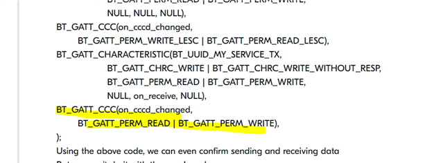

    BT_GATT_SERVICE_DEFINE(my_service,
    BT_GATT_PRIMARY_SERVICE(BT_UUID_MY_SERVICE),
    BT_GATT_CHARACTERISTIC(BT_UUID_MY_SERVICE_RX,
                       BT_GATT_CHRC_NOTIFY |BT_GATT_CHRC_READ | BT_GATT_CHRC_WRITE | BT_GATT_CHRC_WRITE_WITHOUT_RESP,
                       BT_GATT_PERM_READ | BT_GATT_PERM_WRITE,
                       NULL, NULL, NULL),
    BT_GATT_CCC(on_cccd_changed,
            BT_GATT_PERM_WRITE_LESC | BT_GATT_PERM_READ_LESC),
    BT_GATT_CHARACTERISTIC(BT_UUID_MY_SERVICE_TX,
                       NULL, on_receive, NULL),
            BT_GATT_PERM_READ | BT_GATT_PERM_WRITE),
    Using the above code, we can even confirm sending and receiving data
    But you can't do it with the app I made
    So I debugged it, and as soon as I activated BT_GATT_CCC under BT_UUID_MY_SERVICE_RX, I checked that the data was entering the garbage value. When I deactivated it, the data went in well
    Do you happen to know why this is?
  • Hi Min Hyuk,
    I would suggest to copy exactly what inside peripheral_uart and try to compare it with your code to see what change make it doesn't work.
    I don't fully understand what you meant by
    What I don't understand is that why you want to have CCCD for a characteristic that doesn't  have notification property ?
    Please take a look at the peripheral_uart service declaration.
