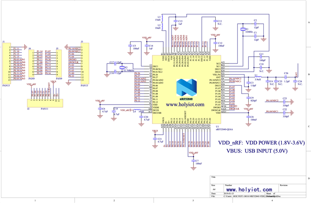

I have a custom nRF52840 module (made by Holyiot 18010) running the default Blinky program with some custom configs. I'm measuring its power consumption with PPK II with source mode on a 3V voltage. If I run the program normally the current consumption hovers around ~10uA (which is to be expected). However, if I have CONFIG_NET_L2_OPENTHREAD=y, the average current jumps to 1mA and stays there.
What is strange is that when I try to run the same program with OPENTHREAD turned on for the nrf52840 DK, the current seems to be back in the uA range. Any idea what could be the problem here? Appreciate any help!

    What's really bizarre is that if I supply the custom board with a much lower voltage on nRF_VDD (the cutoff seems to be about 2.5V), it seemed to have triggered something off. The voltage on the custom board is now running in the ~50-70uA range. This will only happen after I do a reset after the voltage set. Please see the following graph for reference.

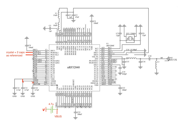

    Your VDDH net is floating. When VDDH/REG0 is enabled, left floating, and more than ~2.5V is supplied to VDD, then current will flow back into VDDH/REG0 and REG0 enters an undefined state.
    See Circuit configuration no. 4 for QIAA aQFN73 for reference.

  • Thank you!! That does seem to be the issue. Is there any way to turn VDDH/REG0 off through config options or firmware since I don't have easy control over the how the custom module was designed?
  • Set BOARD_ENABLE_DCDC_HV=n in your prj.conf file. You also need to remove L4 and C19, and connect VDDH to VDD with a short wire. That should put the board in a good state, though there might be permanent damage to the REG0 stage. Also note that max input voltage is now 3.9V instead of 5.5V.
