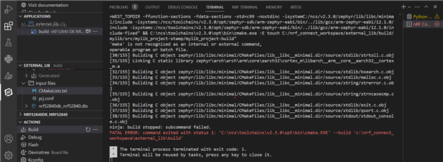

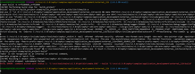

Hi
I am doing it through the same way using bash terminal but it still same error seems to me as below
and same error is seen through VS Code Building as below
Hi!
This sample requires make. Looks like you don't have make installed. See e.g.
https://stackoverflow.com/questions/32127524/how-to-install-and-use-make-in-windows
Thanks a lot Sigurd.
now it is compiled successfully. I am little bit confused here what static lib it is taking as input and what it is generating as output static lib.
