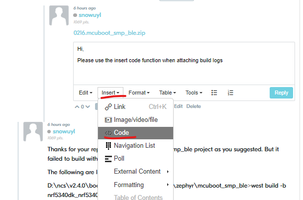

    Please use the insert code function when attaching build logs. It makes it far easier to navigate your case if you do so. And also thank you for providing steps to recreate what you see unprompted. That helps speed up the process.
