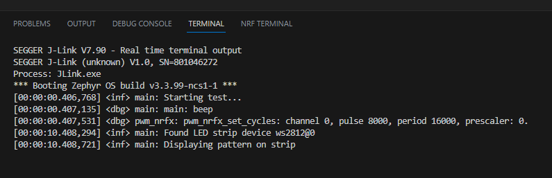

Hi All,
I am unsuccessfully trying to make the buzzer (KLJ-5020) of my custom board with an nrf9160 beep. I have setup the different dts and config files of my custom board by following this tutorial.
I tried different samples including blinky_pwm and this tutorial. The buzzer is connected to the GPIO5 pin, I use VS code and SDK 2.4.1. I use a 3.7V 1000mah battery.
I only have a multimeter for checking the hardware although I am not sure what to check on the buzzer pins, I am a complete beginner in electronic and did not design the board myself.
On the software side I use pwm on GPIO5 to drive the buzzer with a 1000Hz signal (I just want a simple beep). I saw here that GPIO5 on the nrf9160 is a MISO pin, could that be the issue?
I can't tell what is wrong. Any help would be greatly appreciated.
Best wishes

	LOG_INF("Starting test...");
	if (!device_is_ready(buzzer.dev))
		LOG_ERR("Buzeer not ready");
	LOG_DBG("beep");
	pwm_set_dt(&buzzer, PWM_HZ(1000), PWM_HZ(1000) / 2);
	k_msleep(10000);

sources:
3683.hello_world.zip
logs:
