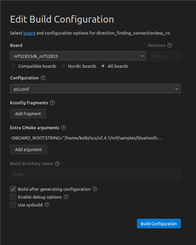

  • So I went through the project you recommended to me. Unfortunately I'm unable to flash my board cause the device is not detected in the VS Code extension. Can you by any chance give me some hints on how to achieve this? I've figured out that the hardware used on the board utilizes a nRF52833-Chip. So I edited the build config (see picture below) and I also checked that all needed software is up-to-date.
    I've also contacted Insight SIP if they can provide further information on that topic.

  • Hi again Marvin
    You'll need to create a board file for the nRF52833 board you're using that uses the correct pins for I.E. antenna switching, etc. The antenna matrix config should be the same for the ISP AOA antenna array as what is already configured in the sample. You can check out our documentation page on custom board configuration here. Hope that helps.
    Simon
