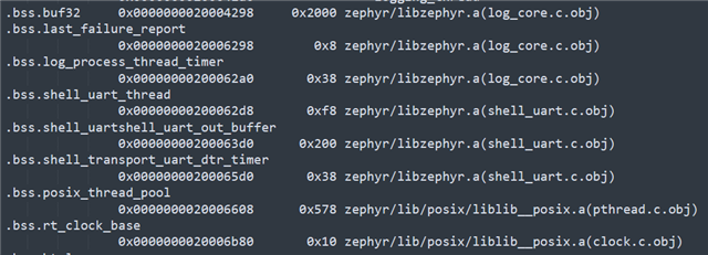

Due to we porting some driver that using posix pthread, now the overflow happen in Current thread: 0x20006838 (unknown).
And I check the *.map file as below:
.bss.posix_thread_pool
0x0000000020006608 0x578 zephyr/lib/posix/liblib__posix.a(pthread.c.obj)
It seems like the posix library stack overflow, is there any soultion can resolve it?

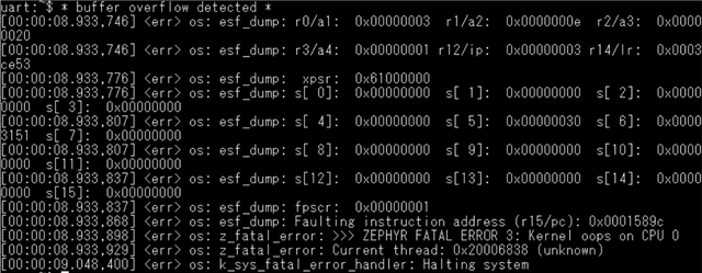

Hi Ian,
Good to hear. The error you are getting now is a "kernel oops", and it is likely related to the "buffer overflow detected" message printed before the crashlog. Can you look up the faulting instruction address (0x1589c) to see where the error is being raised?
Looking up the faulting address with 'addr2line':
arm-zephyr-eabi-addr2line -e build/zephyr/zephyr.elf 0x1589c
Hi Vidar,
I find the error come from the printf buffer is overflow.
I modify it there's no more stack overflow.
