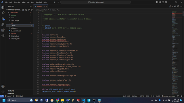

Compiling Central_UART won't work
Current Setup:
nRF Connect for Desktop v4.1.2
Toolchain Manager v1.2.4
nRF Connect for VS Code v2023.2.56
After numerous reinstalling nrfConnect for vscode, nrfConnectDesktop, Toolchain & CMake I can compile and run (with no red warning "#include" squiggles): blinky, helloworld, ICM42605. I'm confident others would work too.
Except Central_UART won't compile...Below is my output. I can see that there are problems, but I am unsure why there are problems and/or how to fix them... I assume it's something specifically related to BLE that I is misconfigured/missing?

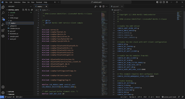

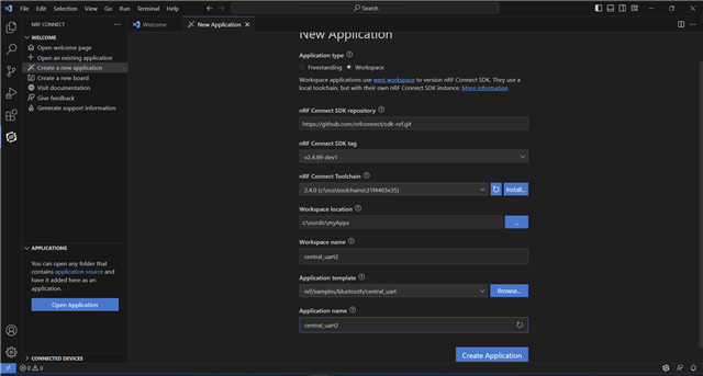

UPDATE: I created a new Central_UART as a Workspace Application Type, instead of Freestanding, and it compiled correctly. I attached images below of the Workspace version in case it helps to indicate why the Freestanding version isn't working.
Is there a problem using Workspace instead of Freestanding? Eventually I would like to combine SPI (IMU42605) and BLE (Central_UART) into one application.

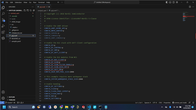

C:/nordic/myApps/central_uart/prj.conf:21: warning: attempt to assign the value 'y' to the undefined symbol BT_NUS_CLIENT
C:/nordic/myApps/central_uart/prj.conf:22: warning: attempt to assign the value 'y' to the undefined symbol BT_SCAN
C:/nordic/myApps/central_uart/prj.conf:23: warning: attempt to assign the value 'y' to the undefined symbol BT_SCAN_FILTER_ENABLE
C:/nordic/myApps/central_uart/prj.conf:24: warning: attempt to assign the value '1' to the undefined symbol BT_SCAN_UUID_CNT
C:/nordic/myApps/central_uart/prj.conf:25: warning: attempt to assign the value 'y' to the undefined symbol BT_GATT_DM
error: Aborting due to Kconfig warnings

    It looks strange that you were able to compile with workspace but not with the freestanding. Could you please try to compile this from command line by using west?
    Thanks.
