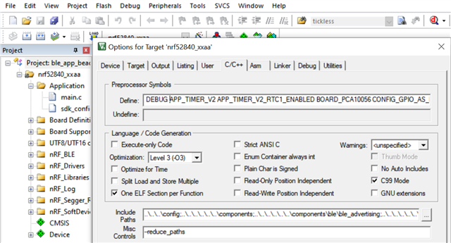

    From your ticket it seems that you are encountering the NRF_BREAKPOINT_COND when stepping through the code in the debugger, is this correct?
    If so, please make sure to add DEBUG in your preprocessor defines like shown in the included image:
    This will make your logger output a detailed error message whenever a non-NRF_SUCCESS error code is passed to an APP_ERROR_CHECK.
    Please do this, and let me know what this error message reads, and which line of code it points to in your application.

    Yes, this is as expected if a non-NRF_SUCCESS error code is passed to an APP_ERROR_CHECK.
    Please add the DEBUG define to your preprocessor defines and see what you logger outputs in this case.
