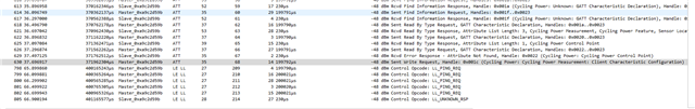

bt_att: att_timeout: ATT Timeout error after subscribing succesfully.
I get the bt_att: att_timeout, on the central side after subscribing to some characteristics of a cycling power sensor. It work for other sensors like cycling cadence and speed.
It's seems like the error occurs on notification.
I've tried differents connexion parameters but here is my current config :
#define BLE_MINIMUM_RSSI    40
#define SCAN_INTERVAL       0x0640 /* 1000 ms */
#define SCAN_WINDOW         0x0030 /* 30 ms */
#define INIT_INTERVAL       0x0010 /* 10 ms */
#define INIT_WINDOW         0x0010 /* 10 ms */
#define CONN_INTERVAL       0x0320 /* 1000 ms */
#define CONN_LATENCY        0
#define PEER_NAME_LEN_MAX   30
#define CONN_TIMEOUT  MIN(MAX((CONN_INTERVAL * 125 * \
			       MAX(CONFIG_BT_MAX_CONN, 6) / 1000), 10), 3200)
const struct bt_le_conn_param BleCentralImpl::conn_param = {
	.interval_min = 0x40 /*CONN_INTERVAL*/,
	.interval_max = CONN_INTERVAL,
	.latency = CONN_LATENCY,
	.timeout = CONN_TIMEOUT,
Here the log (The error happens at the end of the file):

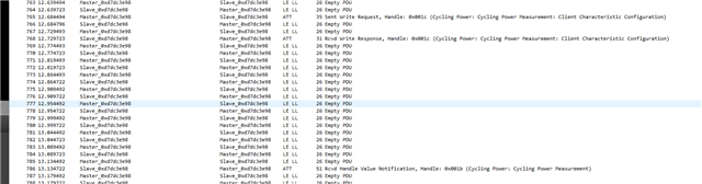

[00:00:11.874,938] <inf> BLE: OnConnectCb: Connected (0): D2:78:94:F0:B8:6C (random)
[00:00:11.900,604] <inf> BLE: Scan: Scanning successfully started
[00:00:11.922,088] <inf> BLE: mtu_exchange: MTU (0): 23
Exchange pending...[00:00:13.565,765] <inf> BLE: OnMtuExchangeCb: MTU exchange 0 successful (23)
[00:00:17.566,650] <inf> BLE: le_param_req: LE conn param req: D2:78:94:F0:B8:6C (random) int (0x0020, 0x00a0) lat 4 to 500
[00:00:24.565,734] <inf> BLE: le_param_updated: LE conn param updated: D2:78:94:F0:B8:6C (random) int 0x00a0 lat 4 to 500
[00:00:26.565,856] <inf> BLE: OnSecurityChangeCb: Security changed: D2:78:94:F0:B8:6C (random) level 2

  • Hi Mart,
    I would suggest to capture a sniffer trace to see what happens over the air. I'm not so sure on which exact ATT request that got timed out.  There is a tutorial on how to use the sniffer trace in this course: https://academy.nordicsemi.com/courses/bluetooth-low-energy-fundamentals/lessons/lesson-6-bluetooth-le-sniffer/
    Do you have control over the peripheral's side ? Was there any assert ?

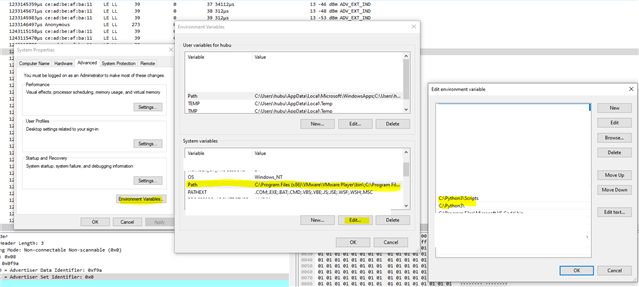

  • I didn't managed to get further than the chapter 1.2 of Installing the nrf sniffer capture tools.
    Can you provide me more information on which folder I need to lauchn the : pip c"py -3 -m pip install -r requirements.txt" command please.
  • Hi Mart,
    Python folder should be added to the System Environment Variables in Windows. In that you need to add the python folder in to the Path so that it can be called in any folder:
  • Thanks but I get this, I think I launch the command from the wrong directory, am I right ?
    C:\Users\dev>cd C:\Program Files\Wireshark\extcap
    C:\Program Files\Wireshark\extcap>py -3 -m pip install -r requirements.txt.
