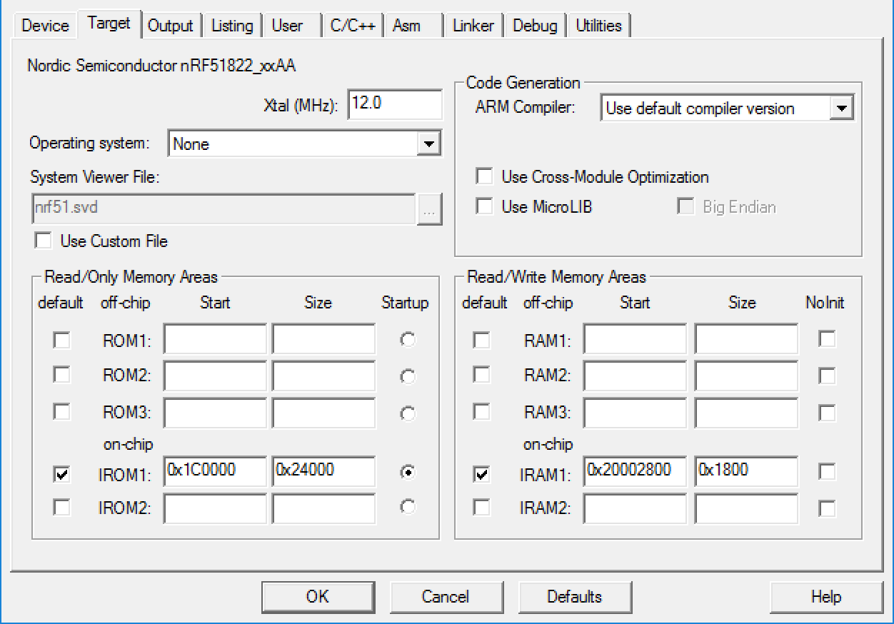

We're using the NRF51822 and the S130 with V9.0 SDK, and we're using most of the features of the SDK for our Firmware; but I'm running into a problem flashing the device on the Keil IDE.
We're able to flash both the S130 to the device and the Firmware to the device using our GCC toolchain, but not Keil. When I attempt to, I receive this error:
nrfjprog.exe --program "Y:\src\myco-firmware\Objects\firm_s130.HEX" --verify Parsing hex file. Reading flash area to program to guarantee it is erased. ERROR: The area to write is not erased.
Using the information from this Nordic Question, I set the following:
IROM1 Start: 0x1C0000  (selected as Start up)
IROM1 Size: 0x24000
IRAM1 Start: 0x20002800
IRAM1 Size 0x1800
image description
What are the correct settings? I'd like to flash it via the Keil so I can step into it (since running the S130 with old firmware (that is known good off of SDK V7.0) or the new firmware (ported to SDK 9.0) results in the board not working at all.

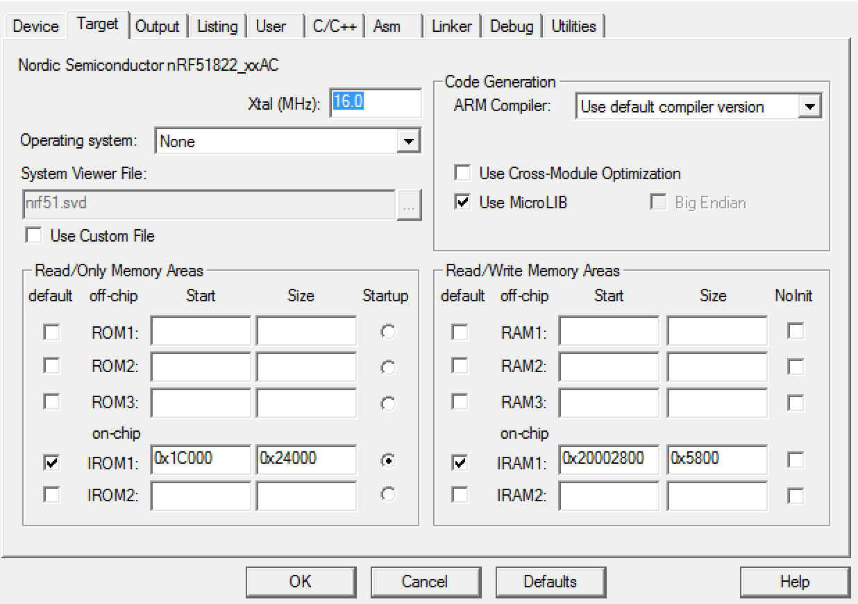

After speaking with someone from Nordic; I changed the ROM1/RAM1 settings to reflect the s130 example for the ble_app_beacon. I still can't download the flash using Keil, and I get this error:

Erase Failed! Error: Flash Download failed  -  "Cortex-M0"
Flash Load finished at 17:40:43
I am, however, able to download the flash file for the ble_app_beacon S130 example.
Here are the RAM/ROM settings suggested for the S130:
image description
  • what are the versions of softdevice and chip your are using? nrfjprog will not allow you to write on dirty pages, you need to erase chip, program softdevice and then program the application. Everything will be flashed correctly if softdevice and application are not overlapping. If they do, then nrfjprog will give error like the one you mentioned.
    Keil on the other part will be able to write on application dirty pages, this means that an application can be flashed to already flashed memory without the need of explicit erase operation. This is because the flash algorithm provided by nordic for Keil will internally erase necessary flash pages. On the other hand this is not the same if Keil sees that the application is trying to write to the softdevice flash area. It will then fail.
