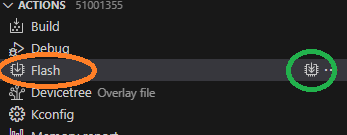

  • Hi Elfving,
    I am flashing the board using a J-LINK Base, directly from VS Code. I've had not issue so far.
    I've tried the following :
    - Removing only the .c code, and keeping DTS and prj.conf  -> Can't program without manually erasing
    - Removing the .c code and DTS, and keeping and prj.conf -> Can't program without manually erasing
    - Removing the .c code, DTS and CONFIG_FLASH=y from prj.conf -> Programming works
    - Removing the .c code and CONFIG_FLASH=y, keeping DTS -> Programming works
    - Removing CONFIG_FLASH=y, and keeping the .c code and DTS -> Can't build, because functions such as flash_erase() are not defined.
    The CONFIG_FLASH=y seem to be the cause of my problem. However, I need it to enable the flash() functions.
    I am not not sur how to get the log. Where should I add "-- log" ?

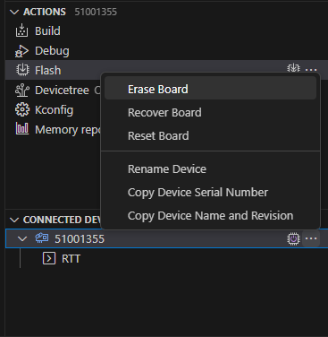

    All these results are when clicking on the "Flash" text (orange circle). I just noticed that using the flash logo (green circle) works in all cases. I am confused about this, since both provide the same output on the terminal, and both initiate a flash erase of the nRF9160 prior to programming.
    Note that this is only possible for flashing, but not for debugging.
