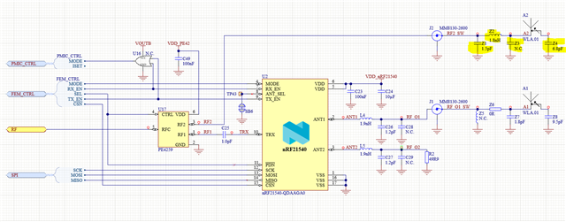

I am designing a PCB for the NRF5340 and intend to utilize a ceramic antenna due to space limitations on my PCB. To achieve this, I am using the Thingy53's RF section as a reference for my PCB design.

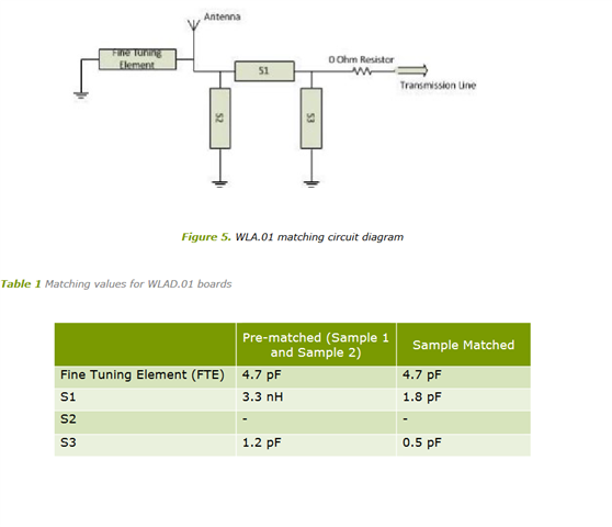

I have observed that the antenna tuning components differ slightly from those depicted in the Taoglas document for WLA.01, which is causing some confusion for me. Please advise on which parameters I should prioritize and use.
Following is the screenshot from Thingy53's RF section.
Following is the screenshot from Taoglas application note (https://cdn.taoglas.com/wp-content/uploads/pdf/WLAD_01-GP-Clearance-Evaluation-test-reportAPN-17-8-001.docx.pdf)
Please advise me on which components I should use for the matching circuit.
