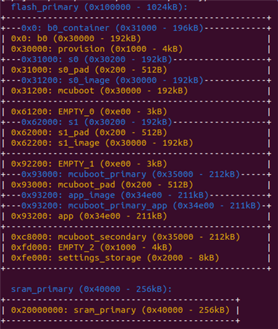

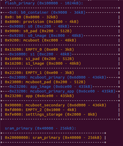

    I tried some samples of the repository you sent me, but I can't make it work unfortunately.
    I saw there that enable the USB_DEVICE_STACK resulted in 10kb increase in firmware size.
    I've restored the file "zephyr/board/arm/xiao_ble/xiao_ble_defconf" to its original state (set CONFIG_USB_DEVICE_STACK) and I have added a mcuboot.conf file to the child_image folder.
    mcuboot.conf:
    CONFIG_USB_DEVICE_STACK=n
    It's working like that (I can compile, flash and perform DFU) but I do not have any logs coming from MCUboot.
    Moreover, my final goal is to add both NSIB (Nordic Secure Immutable Bootloader) and MCUboot to my project to be able to perform update of MCUboot.
    I have adapted the sample : https://github.com/hellesvik-nordic/samples_for_nrf_connect_sdk/tree/main/bootloader_samples/updatable_bootloader/nsib_mcuboot_smp to my blinky project but get the following error (I got the same error when just compile the sample without modifications) :

    I've read that I have to set CONFIG_MULTITHREADING when using USB_DEVICE_STACK.
    I created a conf file "b0.conf" to configure the NSIB bootloader and tried to increase its partition, I did the same for mcuboot.conf and I commented the CONFIG_USB_DEVICE_STACK line.
    b0.conf :
    CONFIG_PM_PARTITION_SIZE_B0_IMAGE=0x10000
    mcuboot.conf :
    CONFIG_PM_PARTITION_SIZE_MCUBOOT=0x10000
    # Required by USB
    CONFIG_MULTITHREADING=y
    # CONFIG_USB_DEVICE_STACK=n
    I get the following error :

    I don't understand where those errors are coming from, I've included the necessary files in main.c
    I'm very confuse.
    Thanks for reading me.
    mcuboot.conf:

    Here is the partition manager report, everything seems ok here (I used here the "child_image/b0.conf" and "child_image/mcuboot.conf" I mentionned in my previous message) :

    Now, I will increase the partitions of the bootloaders.
    b0.conf :
    CONFIG_PM_PARTITION_SIZE_B0_IMAGE=0x30000
    mcuboot.conf :
    CONFIG_PM_PARTITION_SIZE_MCUBOOT=0x30000
    # Required by USB
    [164/174] Linking C executable zephyr/zephyr_pre0.elf

    It seems to have no effects on the "undefined reference to  xxx" errors.
    Do you have an idea of what is going on ?
    This is my project tree :
    Good to see that increasing MCUBoot size atleast removes the overflow error.
    From Build fail using MCUBOOT and SPI on ncs 1.7.1 it's stated that the "spi" driver depends on a multithreaded system, and the errors in linking indicate that your mcuboot config does not have "CONFIG_MULTITHREADING=y" set?
    Do you know if you're using the SPI or QSPI driver in your project? Does adding this configuration change anything on your end?
    If not, could you post your current revision of your blinky with uppgradable bootloaders and I'll have a look?
    Andreas
    Sorry for the delay, I've tested a lot of things for last time.
    I am not using SPI yet, I will add it later to use an external flash. I already have something functional for this feature.
    I updated my blinky project, here it is : blinky_dfu_ota_v1.1.zip
    I have a CMakePresets.json to build 3 different targets : xiao_ble, nrf52840dk_nrf52840 and xiao_custom.
    The xiao_custom is a board I've created, it's a copy of the xiao_ble board, I've just used the UART instead of the USB to communicate between the microcontroller and the computer.
    Everything works fine with xiao_custom target, exactly like the nrf52840dk_nrf52840 target (that use the UART). As I expected, it is the USB stack that the problem.
    For the nrf52840dk_nrf52840 and xiao_custom targets, I've added support for an external flash to store the firmware update. The 2 bootloaders (NSIB and MCUboot) are enabled. This is the final goal.
    For the xiao_ble target, only the MCUboot bootloader is enabled and USB_DEVICE_STACK is unset in the child_image/mcuboot/boards/xiao_ble.conf file. With this configuration, my application compiles and the update via BLE is functional, but I don't have the MCUboot logs on the USB output. How can I get the MCUboot logs on the USB output? I don't want to use the xiao_ble's UART. The NSIB bootloader is disabled by default for this target in the boards/xiao_ble.conf file. When it is enabled, I get the errors of my previous post "unknow reference ..."
    Firstly, I'd like to be able to use MCUboot with the USB stack and secondly to add the NSIB bootloader by enabling CONFIG_SECURE_BOOT on the xiao_ble target.  The xiao_custom board is used for test purposes (because I don't want to use the UART) and has enabled me to understand that these two problems seem to be linked to the USB stack.
