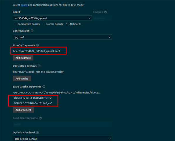

I create a custom board based on nRF5340 with a FEM nRF21540 and I would like to test radio part with some fixed frequency test.
It seems that SDK (nrf connect 2.4) provides a sample for RF test (Direct Test Mode).
After adding my board in the "Direct Test Mode" project, I meet some build error:

FATAL ERROR: command exited with status 1: /home/bgorostidi/Workspace/Toolchains/nrfConnect_SDK/toolchains/1f9b40e71a/usr/local/bin/cmake -DWEST_PYTHON=/home/bgorostidi/Workspace/Toolchains/nrfConnect_SDK/toolchains/1f9b40e71a/usr/local/bin/python3.8 -B/home/bgorostidi/Workspace/Projects/Iot/nrf53_test/direct_test_mode/build_erl -GNinja -DBOARD=erl_nrf5340_cpunet -DNCS_TOOLCHAIN_VERSION:STRING=NONE -DBOARD_ROOT:STRING=/home/bgorostidi/Workspace/Projects/Iot/nrf53_test/direct_test_mode -DCONFIG_DTM_USB=y -S/home/bgorostidi/Workspace/Projects/Iot/nrf53_test/direct_test_mode
My custom board has an UART0  (only TX) for debug and USB capability.

  • Device tree of my board provides 3 ACM ports. But in fact, 4 ports appears on host.
    So, I removed all the ACM ports on my device tree and lets the conf/remote_shell/usb.dts enable 1 port.
      zephyr_udc0: &usbd {
     	 compatible = "nordic,nrf-usbd";
     	 status = "okay";
    // 	 cdc_acm_uart0: cdc_acm_uart0 {
    // 		 compatible = "zephyr,cdc-acm-uart";
    // 	 cdc_acm_uart1: cdc_acm_uart1 {
    // 	 cdc_acm_uart2: cdc_acm_uart2 {
    After this change, only 1 port appears on host and "Direct Test Mode" desktop app can drive the cpunet.
    Many thanks for your help.
