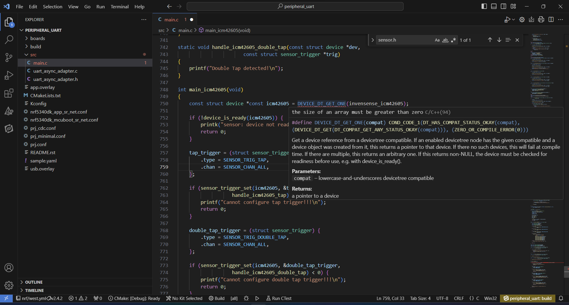

  • As you suggested combining peripheral_uart and icm42605 came together very nicely. It seems very close with the exception of: DEVICE_DT_GET_ONE. I understand this command is used to get the hardware device pointer.
    The ICM42605 code compiles DEVICE_DT_GET_ONE individually, but it doesn't work in the combined file.
    I had to make a small (ICM42605 settings) addition to the prj.conf file, but I'm not sure what needs to be done to the CMakeLists.txt file. I'm getting the following errors related to CMake.

  • I haven't made any headway finding the cause of the problems I outlined. I am betting someone with more experience can probably spot my error?
  • Sorry for the delay. Seems like you forgot to copy the contents of the overlay file from the icm42605 sample. In the boards folder.
  • Thanks! That sorted it out. After a pristine build I get two warnings. Should I be concerned about either?
