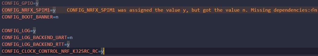

Hi, I created an nrfx spim instance referring to the nrfx_spim example on GitHub, but I'm having a problem.
I added it to the prj.conf file as follows.
Is there anything I didn't know and left out??

Do you have a .overlay for your board in place?
It should look something like this, located in my_project/boards/nrf52dk_nrf52832.overlay:
&spi1 {
status = "okay";
pinctrl-0 = <&spi1_default>;
...rest of configuration
Do you get any complication/cmake errors? If yes, please post these.
Håkon

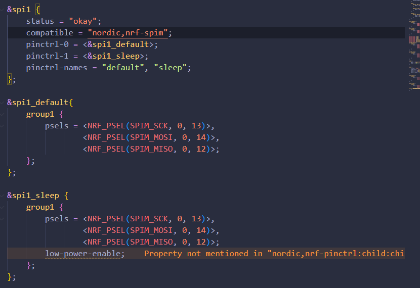

Thank you for your answer.
.overlay file has added settings for spi1 as shown in the picture below, but the error still occurs.
Can you share the full compiler/cmake error?
Håkon
An error occurs when executing the build as shown below.
FAILED: CMakeFiles/app.dir/src/main.c.obj

FATAL ERROR: command exited with status 1: 'C:\ncs\toolchains\31f4403e35\opt\bin\cmake.EXE' --build 'e:\testhere\spitest\build'
There is something strange with your build/project that does not pick up the overlay properly. Try deleting all your build folders and regenerate the project.
Here's a minimal sample that enables NRFX_SPIM1 on nrf52dk_nrf52832:
3731.hello_world_nrfx_spim1.zip
Håkon
