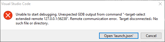

    Now I can flash using Jlink and nrfjprog, but I can't debug.
    When I try to debug I receive the following message:
    Do you think is something related with the board.cmake content?
    Thanks again and kind regards,
    Pedro.
    Exactly what kind of onboard debugger is it? As far as I know, we only support SEGGER J-link debuggers.
