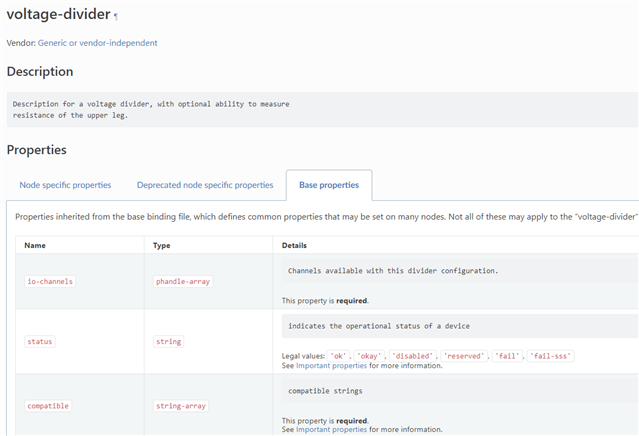

  • Hello Kenneth,
    As per Battery Measurement Readme, either the board devicetree should have a /vbatt node with "voltage-divider" compatible or the ADC config needs to be provided via zephyr,user node.
    Compatible is required property for voltage divider node.
    BR, Naeem

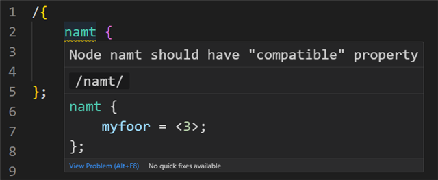

  • Hi Kenneth,
    I get what you are saying, and I can see that the ADC_DT_SPEC_GET_BY_IDX does not require "voltage-divider" compatibility.
    However, when I try to  define a node in the overlay, it immediately informs me that "compatible" is required property for a node.
    (more info here: DTS Bindings and Devicetree Bindings)
    And accordingly, the compatible will also enforce other properties, for example "output-ohms" is required property for "voltage-divider" compatible node.
  • Hi Naeem,
    Ah, so every node mandatorily needs a compatible. This I did not know. Now that solves the problem. I just defined another DT binding as follows,
    description: |
        Analog input channel.
    compatible: analog-input
    include: base.yaml
    properties:
        io-channels:
            type: phandle-array
            required: true
    and wrote my device tree node compatible with this binding,
        batt {
            compatible = "analog-input";
            io-channels = <&adc 0>;
    and now everything works just as I expect it to.
    Thanks a lot for your help!
