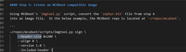

I have tried the solution proposed here but with the BLE SMP transport instead of UART:Update mcuboot with SMP
But it doesn't seem to work as the uploaded image lands in the mcuboot's external flash partition (verified with debbuger that the flash device being opened is the mx25r64).
I'd presume that the binary to be uploaded with mcumgr must have encoded all information needed to upload it to the proper memory address (judged by CBOR decoding implemented here: https://github.com/nrfconnect/sdk-zephyr/blob/main/subsys/mgmt/mcumgr/grp/img_mgmt/src/img_mgmt.c#L508). Does the `signed_by_mcuboot_and_b0_s1_image_update` file meet this criteria? If so, I guess it should be feasible to adapt the mcumgr to handle my case. I'd really appreciate any kind of guide or list of steps required to achieve that.
