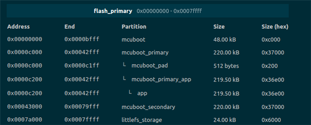

Using 512K NRF52832, the code after minimum size optimization takes 255K.
Trying to add MCUBOOT, I get an error that it does not fit in flash.

If you need to support DFU over BLE and not over UART, you will either have to reduce the size of your application or add an external SPI NOR flash IC to your design to place your secondary slot in.
Typical flash memory layout when using MCUBoot on the 52832 without ext. flash
Vidar
