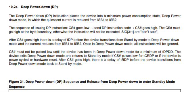

on the nrf5340 DK i want to put the external flash into it lowest power state before i go to deep sleep
i have a custom board with the nrf5340 which uses the same external flash as the one on the nrf5340 DK board.  Before i put the processor into deep sleep with regulators off i want to know what i should do to the external flash to have it draw the minimum amount of power.
should I program the CS to off.  should i program the reset pin to put the part into reset?
should i send the chip a command to go to low power state ?
if so what should i set the CS and reset pins to ?
thanks
