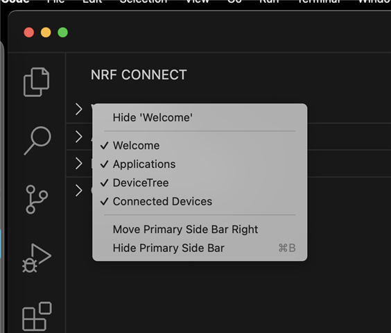

nrf Connect v2023.9.169 Extension for VS Code - how to restore Sidebar to "old" layout!?
I am using nrf SDK v2.3.0 with nrf Connect extension of VS Code on MacOS
The nrf Connect Extension was automatically upgraded to v2023.9.169 last week.
I noticed that the "nrf Connect Sidebar" is now quite different & I find it has missing "sections" (fast shortcuts) that I used to use a LOT on the older versions of nrf Connect Extension.
The older versions sidebar looked like this:
Notice the separate (expandable) "sections for "Sensor_Firmware" (for quick access to source, etc) and the "Actions" section.
My new sidebar (v2023.9.169) now looks like this:
I can live with the new "Explorer" tree of the Application in the new version (it is good BUT it would be "nice" to have a more obvious toggle/section to "show Application in Explorer")
BUT I REALLY would like to get the "Actions" section back on my sidebar!? How do I do that...!?
Is there a way to get that "Actions" section back in the new nrfConnect Extension Sidebar?
I can't figure out how to "get that back"! :)
Of course I like the new expanded "Welcome" section showing the SDK's installed & currently selected or in use.
Thanks!
Gerard

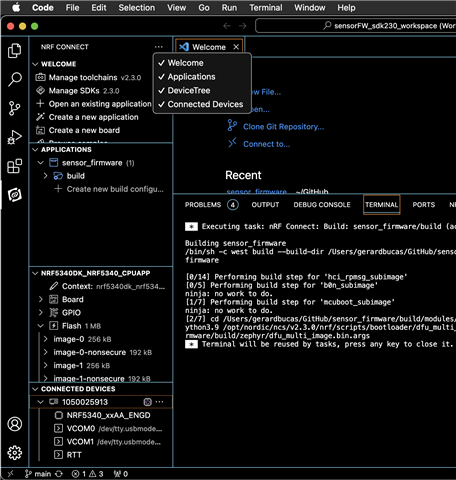

  • Hello Gerard,
    The actions panel should show up again once you create a build configuration for your current project.
    Helmut Lord

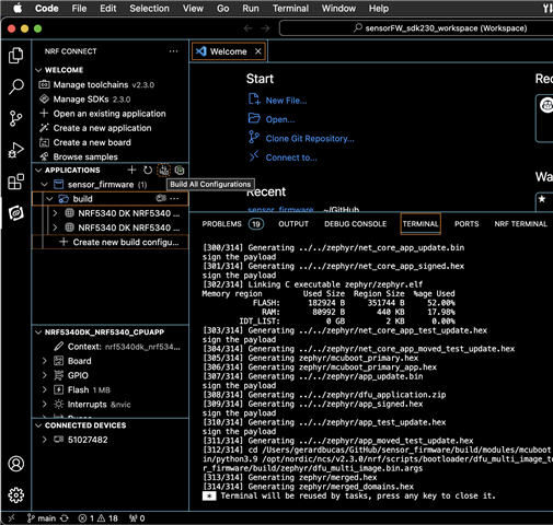

  • Hi Helmut
    Thanks for your super-fast response!
    BUT I already had done a build and still didn't see that Actions Section.
    I have just created and executed a new build configuration and I STILL don't see the Actions Section.
    See new screenshot below.
    Any other ideas how to get it back!? :)
    Thanks!
    Gerard
    Can both of you upload support information from the VS Code extension?
    1. Open the command palette (Ctrl + Shift + P or View > Command Palette).
    2. Write "nRF Connect: Generate support information" and press enter.
    3. Copy the entire support information output.
    4. Upload it here using Insert > Code or upload a .txt file with Insert > Image/video/file.
    Make sure to remove confidential information you do not want to be shared in a public case.
    Marte
