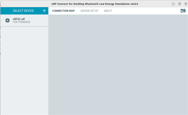

When I select a programmer device (a nrf52840 dongle) It programs the device as a sniffer, when connecting to that device the screen turns blank. cntrl shift i says "devtools was disconnected from page."
2023-09-11T22:19:28.927Z DEBUG Application data folder: /home/bergm006/.config/nrfconnect-bluetooth-low-energy/bundle
2023-09-11T22:19:28.965Z INFO Using nrf-device-lib-js version: 0.4.4
2023-09-11T22:19:28.966Z INFO Using nrf-device-lib version: 0.10.3
2023-09-11T22:19:28.966Z INFO Using nrfjprog DLL version: 10.15.1
2023-09-11T22:19:28.966Z INFO Using JLink version: JLink_V7.92d
ubuntu 22.04
5.19.0-50-generic
toolchain/sdk 2.4.2
app version 4.0.4 standalone.

Hi Boris
Thanks for the information, there is unfortunately an incompatibility which is caused by updating libstdc++6 to 12.3.0-1ubuntu1~22.04. The only available is replacing the libstdc++6 package with an older date tag. I will update the post with a command how to after I have verified it on my end

I'm sorry Boris, I thought I had posted a replay the other day.
So the fix I was recommended was to grab this package
And then either downgrade or you could manually replace the overwrite the files in /usr/lib/x86_64-linux-gnu/libstdc++.so.6.0.30
