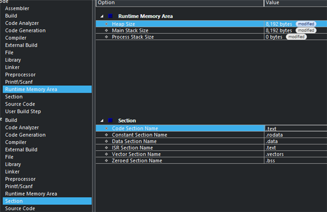

    While I have had noinit working, I'm still not convinced that the linker script is complete when compared to what is created for SES projects. For example, in SES, projects have values defined for Heap Size and Max Stack Size within project options, which are then embedded into the generated linker script. No such information is present within the armgcc projects which I've tried comparing with.

  • Like I said, I do not think no effort has been put to map every default segger IDE settings into gcc linker/memory setting.
    But you can add these configs in your linker script (.ld) and also into your flash_placement.xml file like below
        <ProgramSection alignment="4" size="__HEAPSIZE__" load="No" name=".heap" />
        <ProgramSection alignment="8" size="__STACKSIZE__" load="No" place_from_segment_end="Yes" name=".stack"  address_symbol="__StackLimit" end_symbol="__StackTop"/>
        <ProgramSection alignment="8" size="__STACKSIZE_PROCESS__" load="No" name=".stack_process" />
    I see that you are trying to be cautious in trying to get every setting in SES you have ported to GCC which is very good, but from our end, I do think that no one did this comparison of checking that all IDE's have all default settings to be identical. Some of the default values are not used by some examples, like the heap. Examples does not necessarily use heap but the default values are there in some IDEs and not in some.
