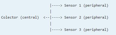

According to specification, SoftDevice (S132) supports three connections as a central. Do you have example project?
I need collect data from 3 sensors:
image description
Thanks and Regards, Nazar
  • There is no multilink example for the S132 in the nRF52 SDK.
    The nrF51 SDK contains a multilink central example (nRF51_SDK_10.0.0_dc26b5e\examples\ble_central\ble_app_multilink_central), you can alternatively port this to the nRF52, the functionality should be identical.
  • For the S132 you can look at ble_app_hrs_rscs_relay located in:
    nRF52_SDK_0.9.2_dbc28c9\examples\ble_central_and_peripheral\experimental\
    This example connects to peripherals of different types and acts as a relay against a second master.
    There is also the possibility to use on the nRF51 examples as shibshab says. Since the Softdevice API's are similar it shouldn't be to much work to port these. However there is a migration document available here.
